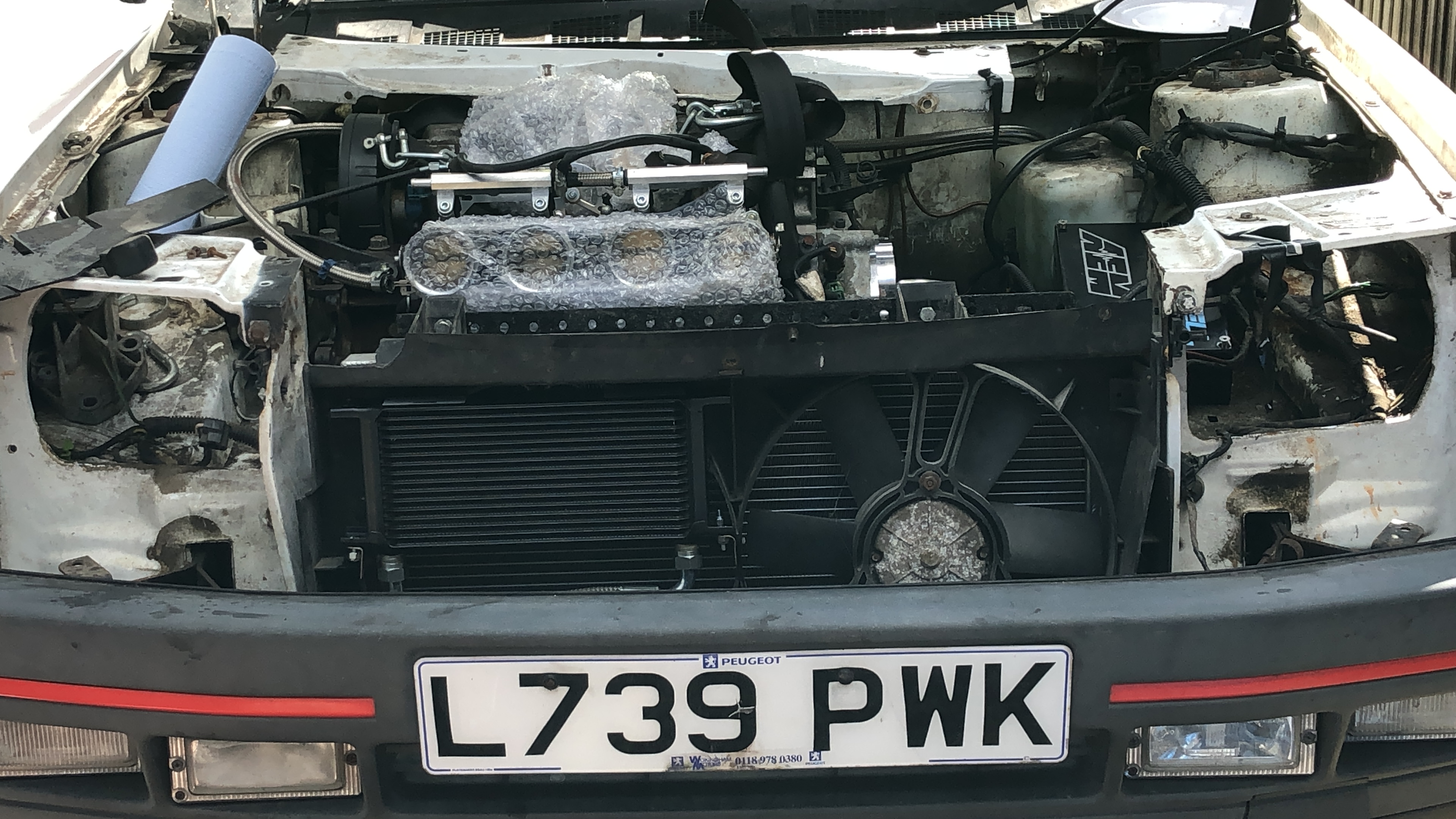

No I used the engine (same engine) and 5 speed gearbox from a Citroen Xsara VTS, tight but fitted straight in. Just changed the diff for a 309 GTI slip diff so I could keep the original driveshafts, also fitted the external gearbox selectors.

if I'm not mistaken, you have also an oil cooler and a 4 butterfly intake (I don't know if we say like that in english), right ?

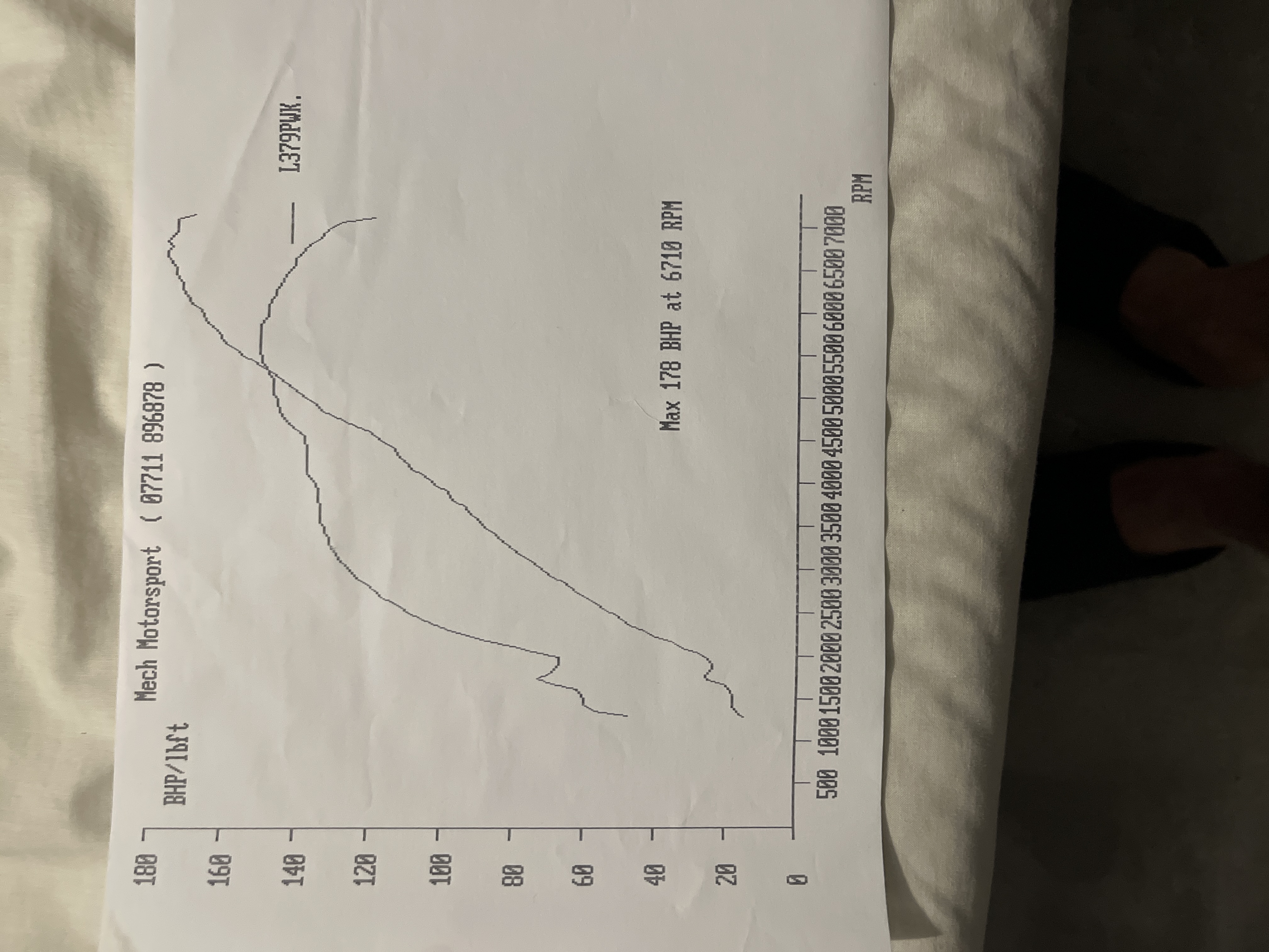

Correct on the butterfly (throttle bodies) it made 178BHP using OMEX ECU on the rolling road
